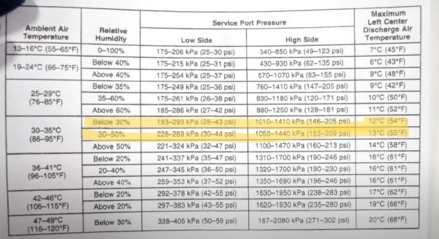

I have a 2012 Ford Fusion SEL. The AC cools and the pressure readings seem normal to me according to the outdoor temps. Outdoor temp was between 83-88 degrees at the time of the video. With that temp outside the refrigerant chart said the low side should be between 45-50 PSI and the High side should be 175-210 PSI. My vent temperatures in idle was 53-55 and while driving it was 50-52. After shutting car off pressures equalize in a little over an hour. Can someone confirm everything is good or if there is something wrong. Thank you
