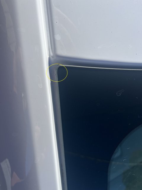

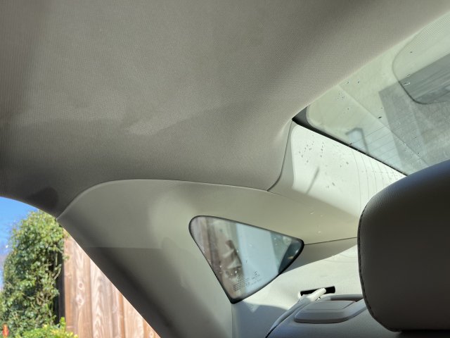

With all the storms we've been having my fusion has been parked outside for a couple of weeks.

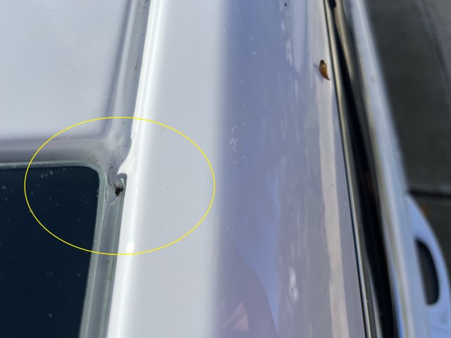

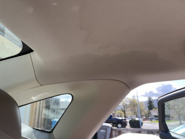

Went to drive it the other day and the headliner and rear shelf areas were soaked. Finally had time to take a look at it today and figured I probably just needed to clean out some drain holes, Maybe replace a door or window seal at worst. During my cleaning I found some cracks!

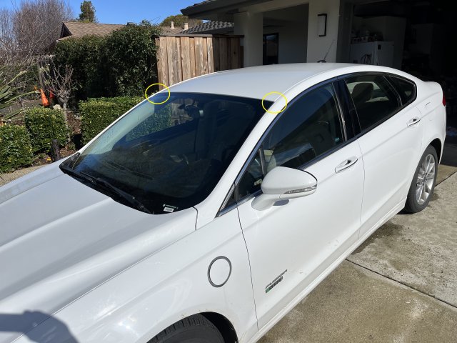

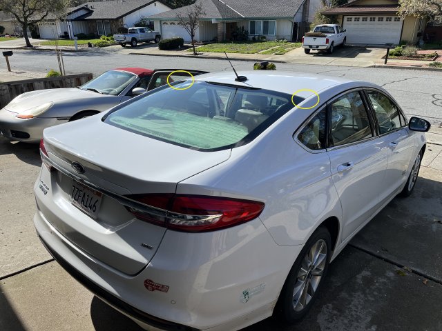

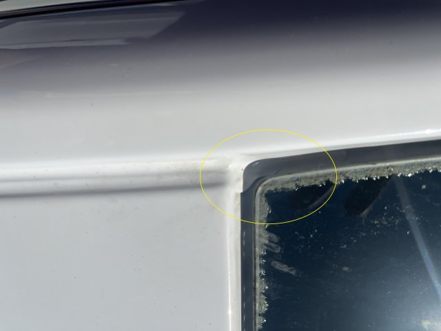

They are located at the top corners of the front windshield and the rear window. Three out of four corners have them. One is a hole surrounded by cracks and the other two are just cracks...
Stress/fatigue?
Wondering if anyone else has seen these cracks on their car? Or am I just unlucky?
It is a white car so they were easy to see once the gunk was cleaned out but they are in a spot I'd never even pay attention to otherwise.

I use a Focus as a daily delivery driver - so I too found cracks in that type of setup in and around the windshield - even though it's been replaced - is showing similar "leaking" and "breaches" in integrity.

Just joined as I should be taking delivery of a 2015 Titanium hopefully later this week. I will introduce officially and post pics later but I have already started poking around the forums and found this thread. I actually noticed a water stain on the headliner and visor on the driver side of the vehicle I’m purchasing. My initial thoughts were someone left the window open a crack and hit it with the power washer or something…. until I saw this. Won’t be able to check it out until I see the car again.
So were you ultimately able to seal it? A bit of RTV? And were you able to remove the water stain?
