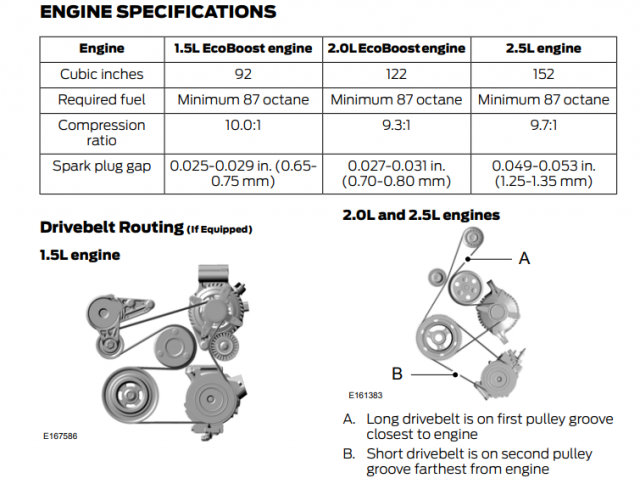

IF the pump is bad, you know what you need to do. If the belt came off - make sure all the pulleys are using it and the belt is threaded thru to make them turn - correctly.
