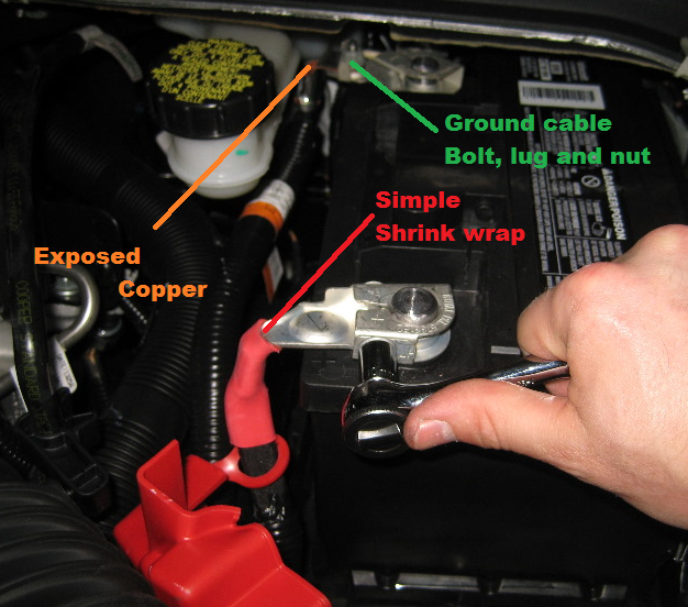

Battery cables come to mind - Both Positive and Ground - Ground is to the back towards the windshield and it's cowl cover.
Best to test the Ground of the Battery Negative POST to a Frame bolt or Engine Block and see if the Ohmic check shoes less than 1Ω (ohm) resistance.
The cables are open, not sealed - just have a simple cover - so they are relatively unprotected.
Fuse box comes to mind, and also the Relays - but that is AFTER you verified the battery is connected to the system well and good enough...
Since it was being driven - and it seems you don't even get DASH lights - those tell-tale ones to show Check Engine, Oil - Battery Seat Belt and the like - suspect the battery CABLE. Uses two, one to the Ground/Frame Body, second supplies power for your dash, or the starter / alternator. That junction - may have corroded to a point it has opened.
The same can apply to the Ground Cable - both to the engine and the frame - the battery terminal - those posts, use a special connector to bolt to the terminal - and provide a hole for a bolt and nut, and the cable it uses, has a lug to fit that bolt and hole to the nut to keep it pressed together.
When you look at these cables - you can see exposed copper, which in itself will oxidize over time and as it does, lose its ability to remain ductile (flexible) and continue to conduct electricity.
