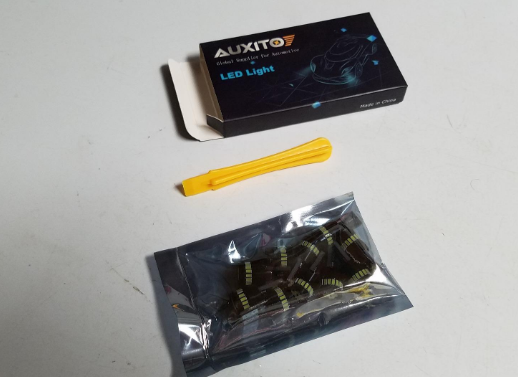

Bought these 194 led bulbs from Auxito for my Fusion lights replacement. Fits right in with no problem. They are much brighter than the OEM W5W bulbs and consumes less power. Many owners mentioned LED failing after 6 mon or a year. That might be due to too much current for the LEDs as there is no heatsink. I didn't want to risk any chance of them failing and having to change them a year later. There are 3 LEDs in series with two 24 ohm resistors for a total of 48 ohm. I changed one of the 24 ohm resistor to 51 ohm for a total of 75 ohms. This lowers the current by about 30% which should extend the lamplife significantly.

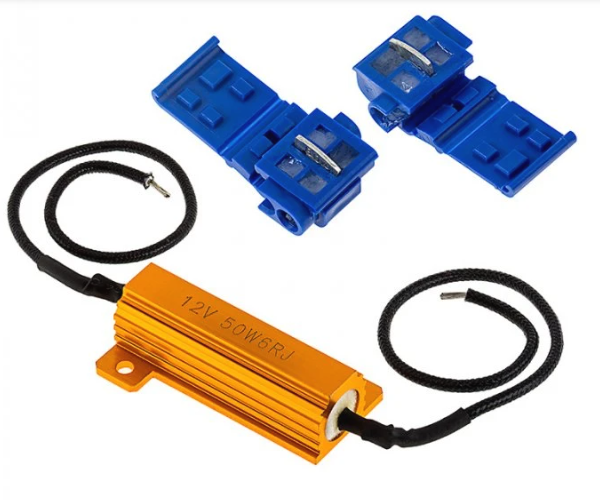

You can extend the life also by using those LED "ballast" resistors that are about 6 to 10 ohms of resistor value.
Use 1 in IN SERIES (cut 1 wire in the pigtail and splice it in to that line) - that is SERIES.
Has to be in SERIES!

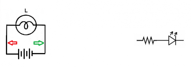

What about Parallel - Parallel is ACROSS the load - which is what many owners of Filament have to do - is place the resistor as the LOAD across the LED - the load then prevents the "hyperflash" many will get switching their systems from the tungsten to LED.
What (it sounds like) you're trying to do is extend the life of LED in that particular application and socket - so that requires some form of a resistive element to offset the boosted and varying voltages seen in todays alternator regulated idle speed to 4,000 RPM daily gunner seated - driver demanded - vehicle, these days.
To extend the LIFE of the LED - due to that brightness and varying voltage - the ballast resistor can power nearly all those LED will little effort in losses - it will also extend the life considerably - by using one LOAD resistor shown and do this for 3~5 LED bulbs per resistor as a series dropping resistor will reduce the current into the LED's own PCB and dropping resistor network .
The clue to a successful install using those units is to find a resistor of 1W value in a 8 to 10 ohm which accomplishes the same thing - only without the bulkier heat sink many will need to drop that level of amperage thru the LED replacement light. This works for "per LED light" - saves the bulky effort and only for those wires to that particular fitting lamp assembly. It also cuts down on the parts count - you're only doing this to one or two branches of a circuit. Unless, of course, you're doing this for Halogens or some other effort.

If you were to take that W5W bulb (168 or 194 or such) and use it for "ballast" instead - that filament will drop voltage across it. Using the filament - being designed as a positive coefficient device - will heat up and show as even more of a resistive element. Therefore, as more power is drawn across (like the Series described above) it will heat up and that heat forces it to pose a higher resistive value to the power flowing across it. Eventually it will begin to glow and you'll arrive to a point of only so many LED bulbs can be fed on this lamp as a branch for power. The bulb begins to consume all the power as resistive element the filament is, against the LED's demanding it.
