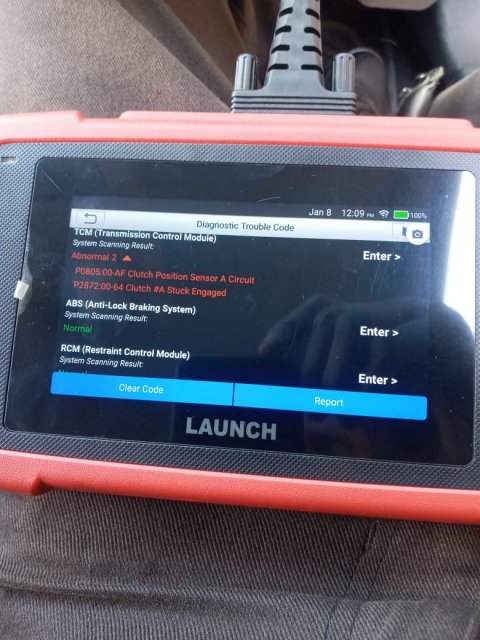

Hi guys, I have a Ford fiesta 2011 1.6 auto. I'm currently having an issue with it.
My management light has come on and the vehicle has gone into limp mode. If I try to drive the vehicle I get warning (not more than 5m) "Transmission hot, switch for 5mins to cool"
We have run a diagnostic in the vehicle and got the following codes
P0805 "Clutch position A circuit"
P2872 "Clutch A Stuck engaged". I have attached a Pic.
The vehicle is out of warranty, if anyone has had this issue before kindly assist.
